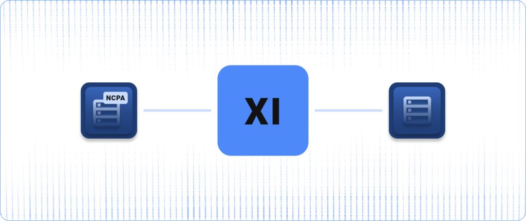

Agent-Based vs. Agentless Monitoring with Nagios
The choice between agent-based and agentless monitoring decides what you can see on a Host, how much work it takes to keep that visibility, and how much load lands on your monitoring server. Nagios XI supports both, so the decision is about fit rather than product capability. This article covers what each method does, which Nagios XI wizards and agents implement it, and how to combine the two in one environment.
What Is Agent-Based Monitoring?
Agent-based monitoring installs a lightweight service on the target machine. The agent runs plugins locally and returns results to the monitoring server, which gives you access to metrics the operating system exposes only from the inside, such as per-process memory, disk I/O counters, and service state. Because the agent runs on the Host, it keeps collecting even when network conditions change, and it can execute scripts that take action on the machine.
What Is Agentless Monitoring?
Agentless monitoring collects data over a protocol the target already supports, with no separate Nagios software installed on it. Nagios XI queries the device using Simple Network Management Protocol (SNMP), Secure Shell (SSH), Windows Remote Management (WinRM), Internet Control Message Protocol (ICMP), or a direct TCP or UDP port check, and evaluates the result against thresholds you set. The available metrics are the ones the protocol exposes. SNMP is often grouped with agentless methods, though the SNMP daemon on the device is itself an agent. The distinction used here is whether a Nagios agent has to be installed.
Agent-Based vs. Agentless Monitoring: The Trade-Offs
ConsiderationAgent-basedAgentless
Metric depthAnything a plugin can read on the Host, including custom checks you writeWhat the protocol exposes, plus custom plugins when using SSH
DeploymentInstall and maintain software on every HostEnable a protocol, open a port, and supply credentials
Ongoing maintenanceAgent updates and patchingTied to operating system and firmware updates
Change approvalOften requires sign-off from the system ownerUsually faster to approve
Load placementCheck execution happens on the monitored HostCheck execution happens on the Nagios XI server
Check directionActive and passive, depending on the agentActive, plus passive through SNMP traps
RemediationEvent handlers and Actions can run scripts on the HostPossible over SSH where a script is available
Most environments end up mixed. Use agents on the systems where you need depth or automated remediation, and use native protocols everywhere else.
